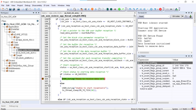

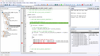

2024-10-05 5:19 AM
@FBL Thanks for helping me dude.
