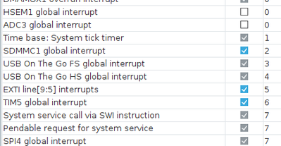

important is INT priority ... :)
usb is highest of other int , see:
