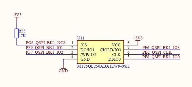

I designed custom board for stm32h745xit6 .
My TouchGFX working fine with internal flash .
_legacyfs_online_stmicro_images_0693W00000dDVHoQAO.pngThe core board has mt25ql256a and connected as under
PB2 CLK
PG6 NCS
PF8 D0
PF9 D1
PF7 D2
PF6 D3

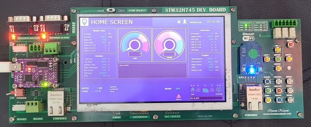

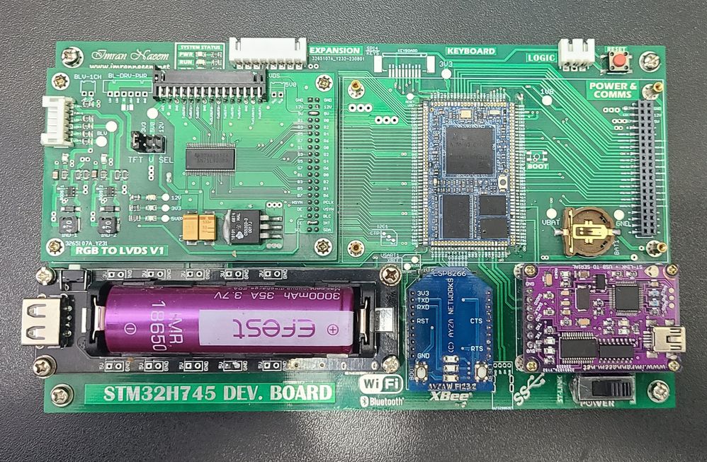

Here is my custom designed board with STM32H745XIT6 & 1024X600 RGB TFT with TouchGFX.
CM4 running Modbus Master RTU
CM7 running TouchGFX with 256MB SDRAM

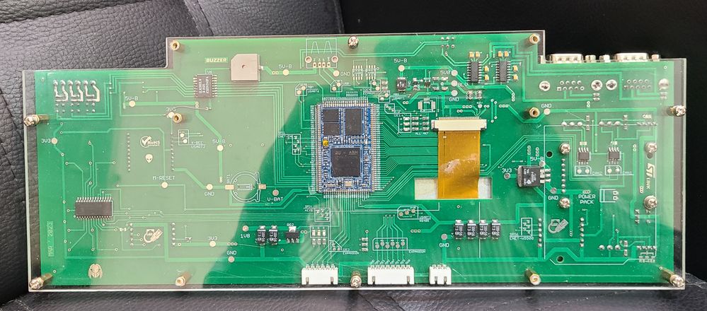

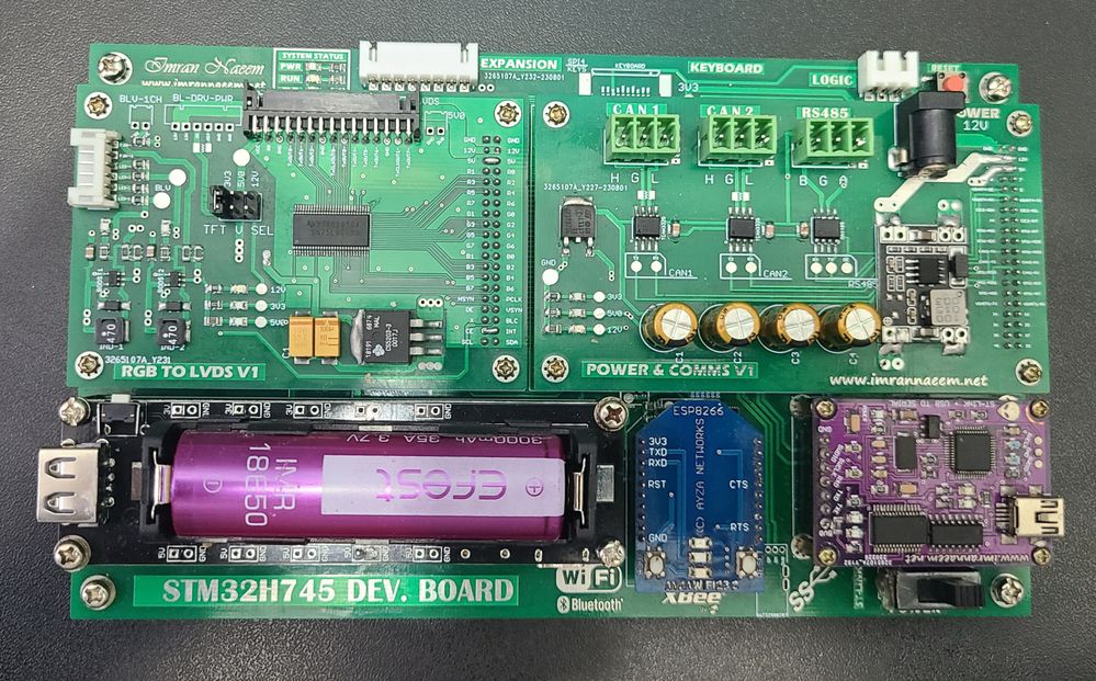

Here is my new version custom designed board with STM32H745XIT6 with add-on cards for different types of lcds like LVDS , RGB , HDMI , DVI , VGA .
Presently RGB TO LVDS card is fixed on left side with SN75LVDS83B (RGB to LVDS Bridge chip)20230811_104031.jpg20230811_104211.jpg

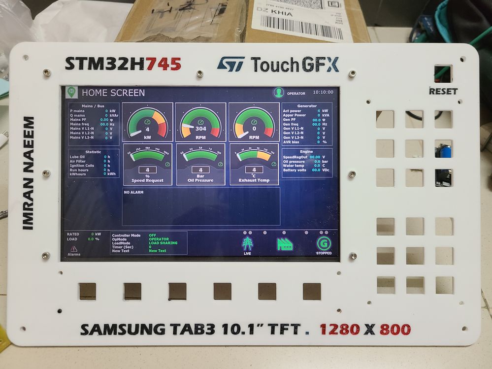

Here is TouchGFX , running on SAMSUNG TAB3 10.1 inch ,, 1280x800 , LVDS LCD (STM32H745XIT6 + SN75LVDS83B)
Its running on same above board which I developed 3 weeks ago ..

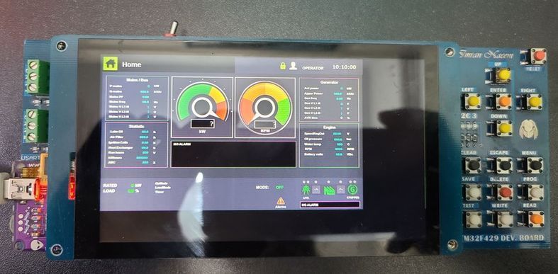

Here is TouchGFX , running on 5.0" ,, 720X1280 ,, RGB + SPI TFT with STM32F429i-DISCOVERY on back side.
LCD PART No. TL050HDV31CT5-H1206A
The lcd driver chip/COG is NV3052

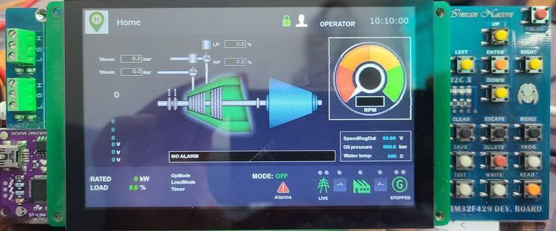

Here is TouchGFX running on STM32F469i-DISCOVERY

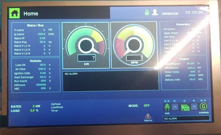

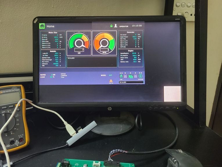

Here is TouchGFX running on HP S1932 18.5" Monitor's LVDS LCD with 1366x768 resolution .
The lcd part no. is LTM185AT04 or Equivalent . The driver is STM32F429i-DISCOVERY + SN75LVDS83B
