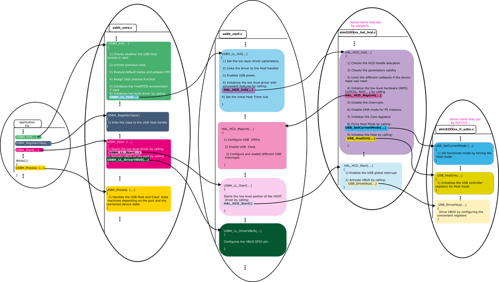

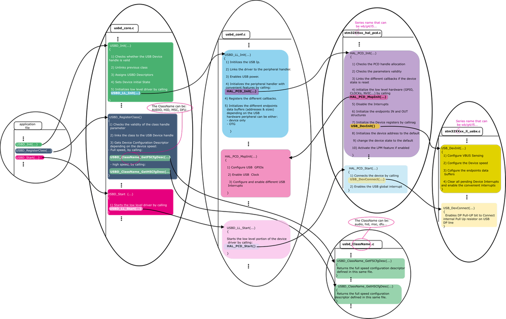

First, the interpretation depends on the product family in question. Messages are fully described in USB specification. The process to enumerate USB device is as follows.
Now, the implementation of ST USB library,
usbd_core and usbh_core files include the implementation of the core state machine process and the enumeration and the control transfers processing.
usbd_ctlreq and usbh_ctlreq files include the implementation of the processing of the control requests required for the device enumeration.
usbh_ioreq and usbd_ioreq files include the implementation of different USB transactions process.
In host mode:
In device mode:
USB stack ensures the correct reception and decoding of the host request and then device state modification accordingly. For further details I suggest you this interesting WIKI
