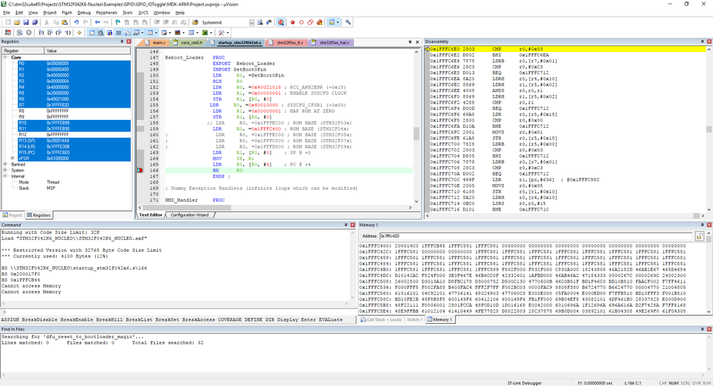

EXPORT Reboot_LoaderIMPORT SetBoot0PinLDR R0, =SetBoot0PinBLX R0LDR R0, =0x40021018 ; RCC_APB2ENR (+0x18)LDR R1, =0x00000001 ; ENABLE SYSCFG CLOCKSTR R1, [R0, &sharp0]LDR R0, =0x40010000 ; SYSCFG_CFGR1 (+0x00)LDR R1, =0x00000001 ; MAP ROM AT ZEROSTR R1, [R0, &sharp0]LDR R0, =0x1FFFC400 ; ROM BASE (STM32F04x)LDR R1, [R0, &sharp0] ; SP @ +0MOV SP, R1LDR R0, [R0, &sharp4] ; PC @ +4BX R0ENDP ;Snapshot when the code is jumped to system memory bootloader. Notice the jump to the code location 0x1FFFCB45 as per the memory window showing the value at the reset vector address.

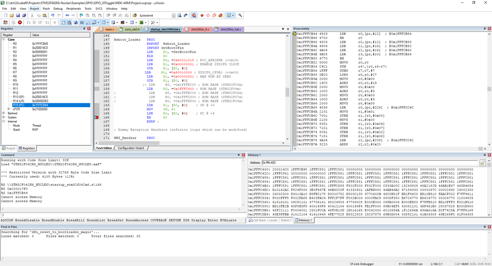

Allowed the code to run for some time. Notice the change in PC register shown in the registers window

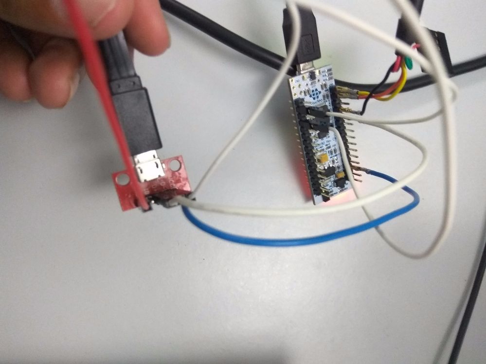

I've used a small break-out-board to takeout usb signals to the host machine. As I could not see usb enumeration happening, I've also used FTDI usb to serial cable and connected it to the nucleo board. See below for connection details.
