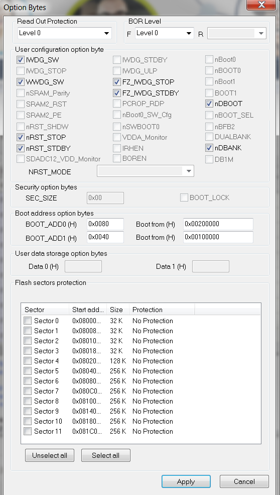

Reading the options bytes, which should be fine, I got:
Could you please suggest a workaround to overcome the USB enumeration problem? probably I am missed something?

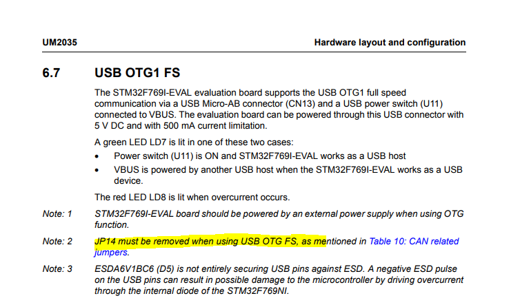

2018-02-15 5:39 AM
yes in fact JP14 must be removed when using USB OTG FS.
-Nesrine-
2018-02-15 6:46 AM
Indeed I overlooked that instruction.
I think it's worth it to mention that information or refer to the USB OTG FS chapter in the boot configuration section.
Thanks,
Aymen
2018-02-15 7:00 AM
Hi ,
Please refer to
user manaul-Nesrine-
