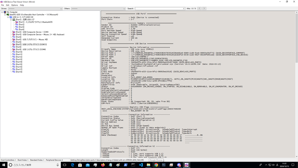

2024-10-14 7:37 PM
Thanks for the help!
I tried your solution, and it worked. thanks so much!
But, I couldn't receive "Hello World" via the serial monitor.
code for main.c: https://drive.google.com/file/d/1qhAVHpmE8YTxBzh6OTw-7OyXdQzXE5hh/view?usp=sharing
vs code serial monitor output: https://drive.google.com/file/d/1XpSgxi50n2FgdIBYnoXeJt2oFSuEADrB/view?usp=sharing
Photo of actual setup: https://drive.google.com/file/d/1CaISDs0JhdvX8R-v1aF5v3VRw-qJxJu7/view?usp=sharing
USB Device Tree Viewer: https://drive.google.com/file/d/1VMC-ssH2HegwjDNyY9PAutBeFFSj1LSf/view?usp=sharing

2024-10-15 1:01 AM
@Richard Li
I tried changing the cable(support usb2.0, U2C-MF50BK), but result was the same .
I think it is probably recognized in HS because USB Device Tree Viewer show high speed.
========================== Summary ========================= Vendor ID : 0x0483 (STMicroelectronics) Product ID : 0x5740 USB version : 2.00 Port maximum Speed : High-Speed Device maximum Speed : High-Speed Device Connection Speed : High-Speed Self Powered : yes Demanded Current : 100 mA Used Endpoints : 4
