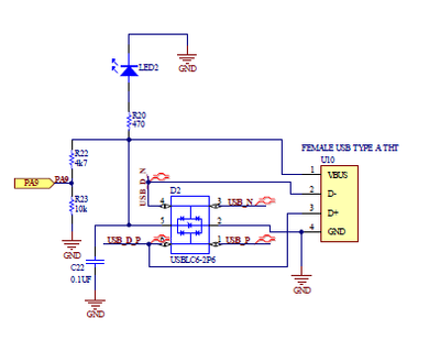

I am seeing LED is glowing even when USB is not connected to HOST laptop. Intensity of LED glowing is low. Anyway, on connection to HOST laptop, the LED glow at high intensity which makes sense.
I am not using PA9 for VBUS detection. I set PA9 in reset condition and also rise/fall edge detection with PD but still LED2 is glowing.
Does USB hardware in STM32 always provide some power to PA9 pin ?
2024-06-19 12:10 PM
If you have usb-device active, there is a pullup (1,5k) on DP , so host can check: there is something...
and you have the diode-array , so the "+" pullup comes to the LED.
Thats the side-effect of your circuit with protection , just check voltage at VBUS, when not connected - and you see.

I made some tests configuring PA9 with USB_OTG_FS_VBUS, with the recommended resistor bridge as per STM32.
Unfortunately, there was some kind of pull-down resistor configured for PA9 (may be by PCB has an issue?) 27k, and then the value read was 1.81V instead of 3.38V expected. I was missing something for sure.
Finally, detecting that the VBUS is 5V through the bridge but PA9 configured as logical input (no pul-up no pull-down) made the trick. That was sufficient for me to read the value in the main loop. Which means that any kind of GPIO digital input can do the job.
As I can change that easily the hardware design, I didn't want to go further and test other pins. I think that with a proper interrupt, it would be better than polling in the main loop.
I strongly recommend to use the resistor bridge, as under some condition, the pin could be damaged in transitory phases (e.g. power through USB)
