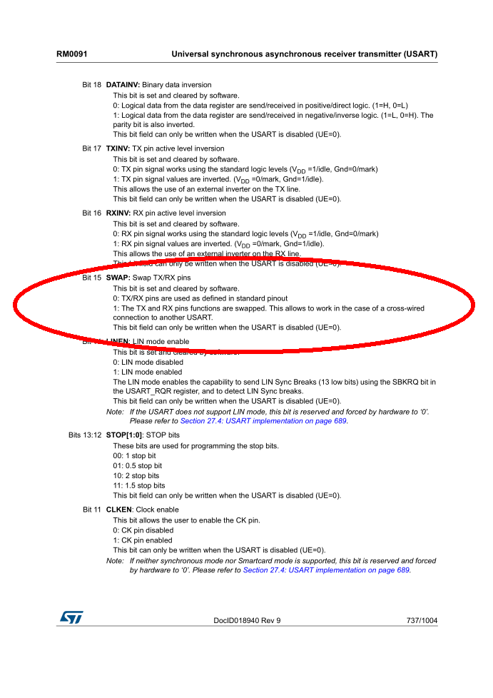

'swapping TX to PC11 works' doesn't make sense. PC11 only offers USART4_RX and no TX from any USART. Are you sure you're identifying the pins correctly?

'Why is it the when I use the following command :
USART_SWAPPinCmd function I can see data on PC11?
'Why indeed! I was unaware of this feature and had used the STM32Cube graphical view of the part to look at the available pin functions. With the
/external-link.jspa?url=http%3A%2F%2Fwww.st.com%2Fen%2Fevaluation-tools%2Fnucleo-f091rc.html
available from Mouser (UK) for£8.71,you might just buy one and see if it has the same problem ... but first, I'd do as Jan W. suggests and check the bits in all those USART configuration.

Hi John

''swapping TX to PC11 works'' doesn't make sense. PC11 only offers USART4_RX and no TX from any USART.
Huh, I've never seen such a weird feature on an USART... funny but, honestly, I can't think of a scenario where this could be really useful.
To the original problem: read out the relevant GPIO registers content if it's set properly.
2017-05-19 4:37 AM
I came across it some years ago with another F0 device, so it is not really new for ST devices.
+1
This issue is perhaps a candidate for the errata.
