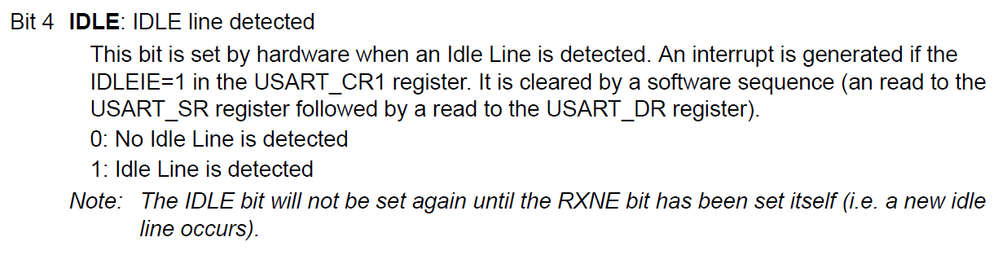

Generally, in UART, transmitter and receiver are almost entirely independent units, so you can't "refresh" the Idle timer by transmitting.

The RM of the STM32F4 says IDLE is only set for reception events. Perhaps the data on the line is not what you think it is.

Transmitting doesn't affect the IDLE flag. Look somewhere else for the solution.
