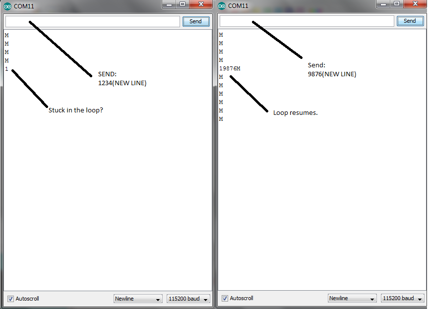

I have been trying to understand what I am doing wrong with my serial communication. I am using STM32L Discovery board and have successfully sent and received bytes on my board/PC. I would like to send bytes from my PC to the board until a NEWLINE constant is received and then continue with the main loop. My code works to some extent:while(1) {

The problem is, when I send the data for the first time, the program is stuck in the inner loop (as it though did not receive the newline). When I send the data the second time, it works as I expect. Please see the image below for more clear explanation.
