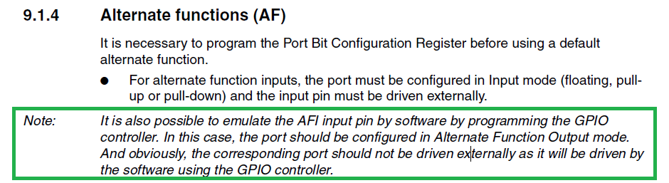

I digged into the reference manual again. Found this:
2013-06-14 5:13 PM
That would work for an F1, the F2/3/4 less so, you'd didn't state which part you were using.
Input Capture is not incumbered by the issues you mentioned for the PWM Input mode.2013-06-15 4:34 AM
I use a STM32F103.
