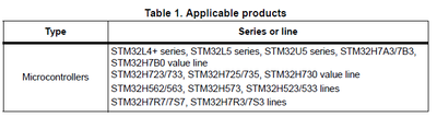

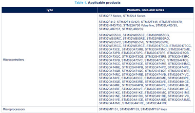

I prefer to provide you some application notes on which there is a table showing the devices featuring peripherals you are needing then you can decide youself according your needs:
DSI: see details in this AN4860 Introduction to DSI host on STM32 MCUs and MPUs:
QSPI: see details in this AN4760 Quad-SPI interface on STM32 microcontrollers and microprocessors
OCTOSPI: see details in this AN5050 Getting started with Octo-SPI, Hexadeca-SPI, and XSPI interfaces on STM32 MCUs
