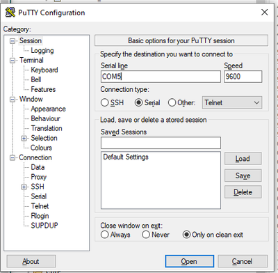

2024-05-16 1:11 PM
Sorry the system didn't allow to send more messages @Karl Yamashita
I use Putty and this is the settings:
I use "\t" so there is a tab space between measurement.
