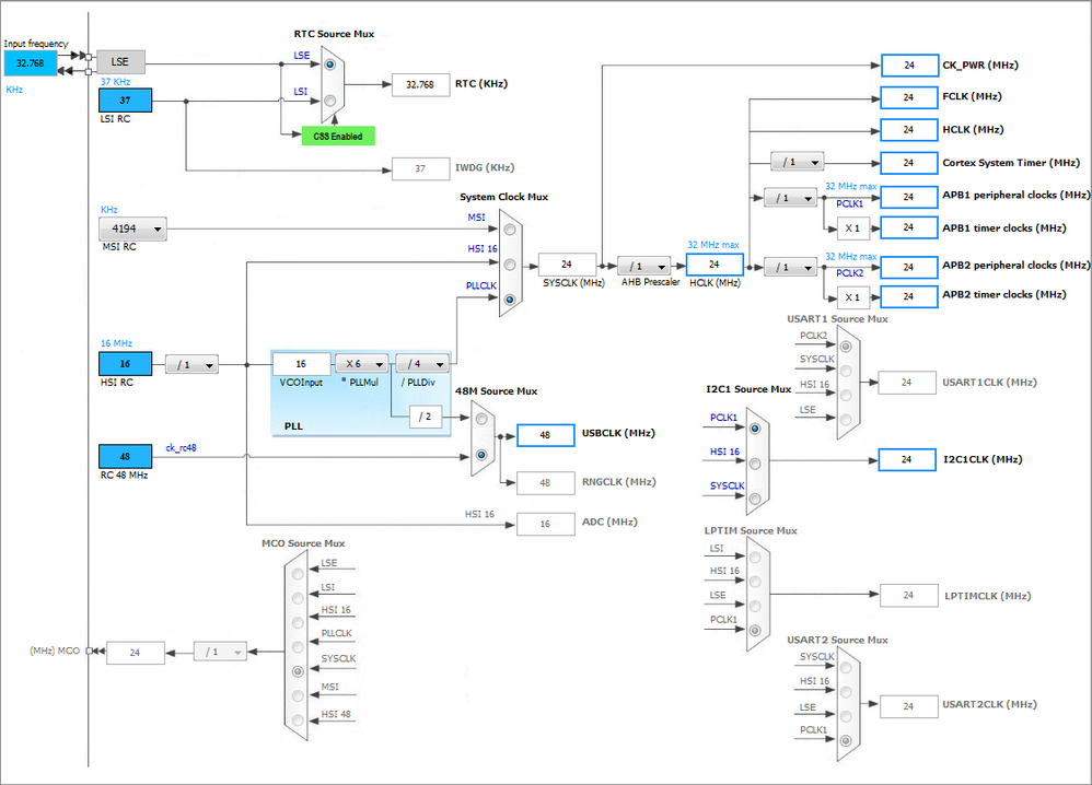

UPDATE:
(Note: This happens only after the first startup. If I power the device down and back up, evetything works)
1.Program executes
HAL_PWR_EnterSTOPMode();
2.The processor does not go to STOPMode and goes straight to another function which is
SystemClock_Config();
3.I get HAL_TIMEOUT @ stm32l0xx_hal_rcc.c line 695
while(__HAL_RCC_GET_FLAG(RCC_FLAG_HSI48RDY) == RESET)
   if((HAL_GetTick() - tickstart) > HSI48_TIMEOUT_VALUE)
      return HAL_TIMEOUT;
Attaching my clock configuration below (supply voltage 2.2V):
