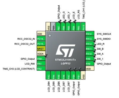

I'm trying to design and build my first STM32 project, a timer. I'm using the STM32L101K4 and have it configured as illustrated in the attached screenshot. The pins are configured in STM32CubeIDE as:
External LSE on 2 & 3
LCD connections on 7-13, 25-27. Pins 8 and 25 are PWM pins to control the LCD's backlight and contrast.
A rotary encoder and push-button switch on 19-21.
Some LEDs on 22, 28 & 29.
SWD on 23 & 24.
And, an unassigned GPIO pin on 30.
I also have configured:
System Core->RCC->LSE
System Core->SYS->Debug Serial Wire
Timers->TIM2->Channel 1 PWM Generation and Channel 3 PWM
All of these are configured without conflict, I think.
I'm puzzled now that I can't assign a role like GPIO_Output to unused pins, such as 6, 14, 15, 18 or 31. Assigning a role such as GPIO_Output (I didn't try other roles) generates a conflict in the configuration, with yellow triangles and magenta backgrounds.
Is it true that, because of the configuration I've chosen, these pins must remain unused? Can anyone explain why?
Second question, mostly unrelated to the main question of this post: What's the difference between 'pinned' pins (such as 13 or 19-22) and 'unpinned' pins (such as 9-12)? What does 'pinning' control?
As always, thanks for any advice or guidance. I really appreciate the expertise in this group.
-Kevin

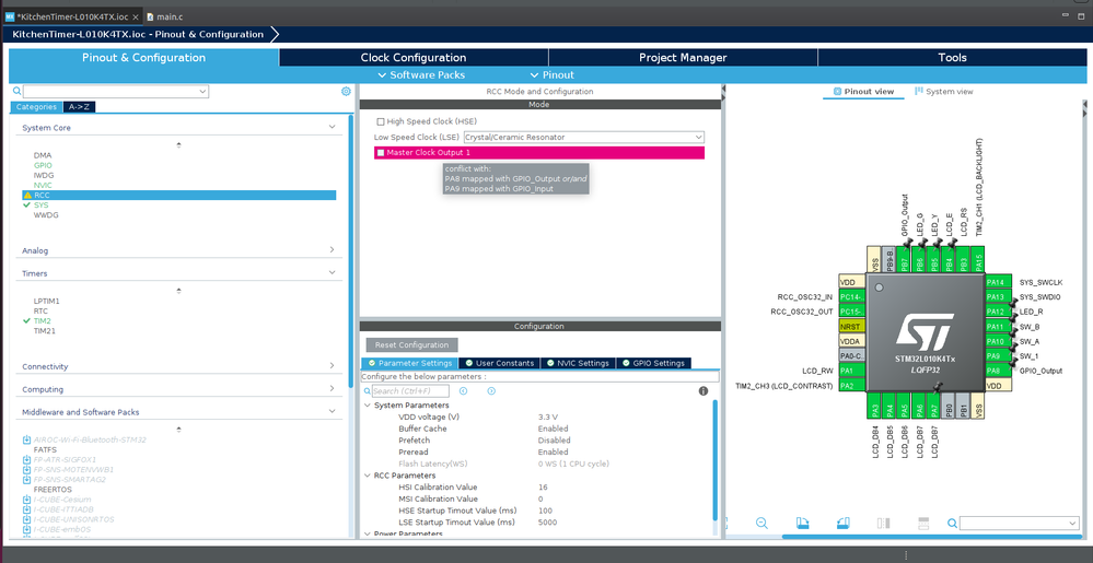

Your IOC didn't show any errors when I opened it, and I'm able to assign unused pins as output without seeing any errors.
I am on an updated CubeMX version compared to you. I doubt that's the problem but it could be.
KevinZ
Associate III
This is what I see, if I try to map PA8:Screenshot from 2024-01-10 10-54-24.png
TDK
Super User
That is saying you cannot enable Master Clock Output 1 because the pin is already used. It's not an error or something you need to fix.
KevinZ
Associate III
@TDK, okay, thanks. I'll note that for the future.
