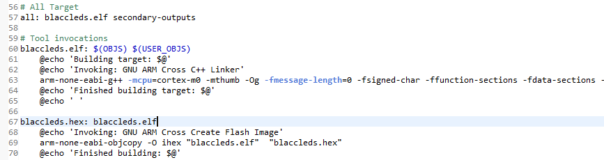

2017-07-13 8:11 AM
What's going on at line 61 of the make file?
What's the script it is trying to run?
2017-07-13 8:38 AM
This is the part of the makefile:
