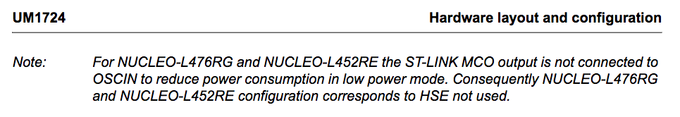

Have you verified that the MCO from the ST-Link is coming to the L476 ? Depending on the board the bridges are not always the same default. So the L476 might be spinning in the error handler because it cannot 'see' the clock at all on its pin.
