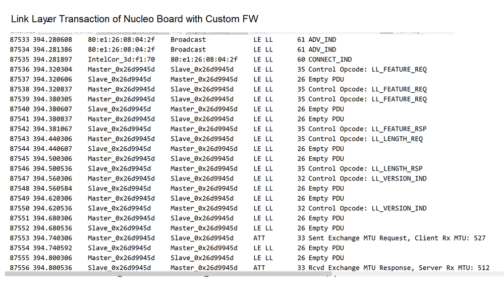

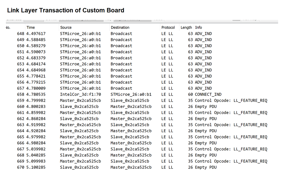

My custom board can advertise well and can intermittently connect to my Windows laptop. However, if i load my FW to a Nucleo WB55 board, I can connect to my Windows laptop consistently.

I attached the Link Layer traffic of the custom board and the Nucleo board for reference.
