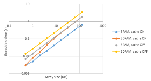

Below graph shows the result of my execution, while varying the size of arr.
As you can see, all graphs shows linear execution time increase as the array size gets bigger. This is expected; if the array size gets x2, the execution time also gets x2. Also, for both SRAM and SDRAM, cache ON is faster, as expected.
However, SDRAM when cache ON (orange line), shows a weird non-linear behavior. As you can see, array size x2 increases the execution time more than x2, especially when the array size is small. When the array size is larger, it is mostly x2.
Because of the non-linear behavior, the SDRAM gets more penalty as the array gets larger, when cache is ON.

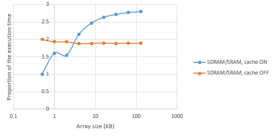

Below graph shows the execution time of SDRAM divided by SRAM on various array size, both with cache ON and OFF.
As you can see, when the cache is off, the performance ratio is roughly a constant. When you turn on the cache, The slowdown gets larger as the arr size grows, even getting larger than the cache-off case.
From my understanding of how a cache works, this should not happen.

I am initializing the array in the code, before the loop. So, it is even more weird, because as you said when the array is smaller than the cache it must stay in the cache.
As you can see, when the array size is smaller than the cache, SDRAM is still slower than SRAM (not the same, even though both should be in the cache). Also, as the array size gets larger, SDRAM gets slower than the SRAM comparably.
2020-02-18 8:06 AM
Oh, I interpreted the second graph the wrong way. Strange indeed.
