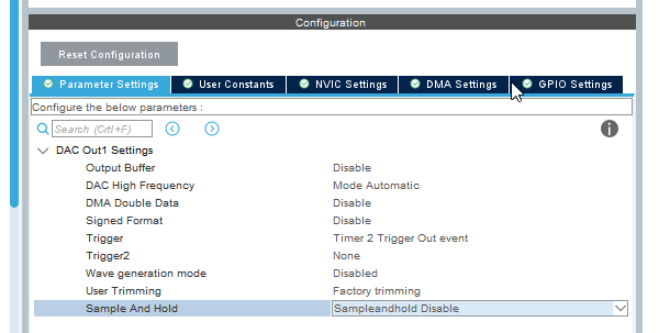

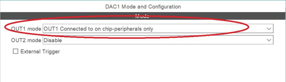

You mean this one0693W00000GXOluQAH.jpgand this one
sConfig.DAC_OutputBuffer = DAC_OUTPUTBUFFER_DISABLE;
 BTW, I am using CubeIDE not CubeMX
I used back the original OPAMP_PGA code, now the DAC output voltage is sustained. Thx.
Igor Cesko
Hi HDaji.1 ,
Mode should be "Connected to external pin only".
And "Sample And Hold" should be "Sampleandhold Disable" :
0693W00000GXYX4QAP.png Regards
Igor
