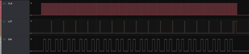

Here's the output that I expect and that I can achieve using the code above:
Mind that this is a one-off transfer, and is only output when I call the two functions above.

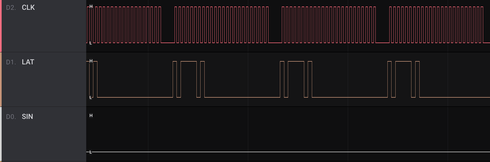

If I do not set both of them, weird things happen. This is the output if I remove the `DdrHoldHalfCycle` parameter:
Mind that this is a continuous signal, which starts and won't stop after I called the transmit function.
