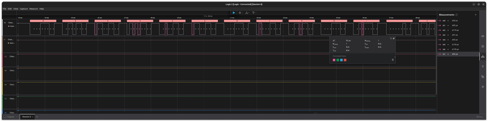

I’ve attached a capture from a logic analyzer. For a 9600 baud 8N1 UART one would expect a byte time (8 data, 1 stop, 1 start) to have a duration of 1.04ms – which I what I measured (the 1.07ms likely includes a small delay for the UART transmit data register to be refreshed.
Likewise the bit times are expected to be around 104us – a tenth of the byte time. However you can see that the duration of the high voltage is highly variable, and as low as 92us – a big timing error for a UART.
We double checked that this is not a function of the sampling rate of the logic analyzer.

If lpuartckpres is 32768Hz the 256 multiplier might be expected to give a time granularity of 0.1us – but the logic analyzer is showing bit timing deviations of > 10us, and since the pclk is 80MHz we’re at a loss to explain such large bit timing deviations.

This is how LPUART works. Still, I cannot see anything wrong with it as long as there is no danger of having 3 middle-bit samples inconsistent.
