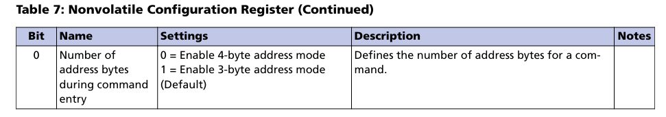

I am trying to reset bit 0 of the nonvolatile cfg to allow 4-byte addressing in commands by default after next reset.

I don't know what pattern was written. I coded an initialization function (without testing which was a mistake) that would copy the current nonvolatile cfg, reset bit 0, then write to nonvolatile cfg using the initial code provided which is now the current issue.

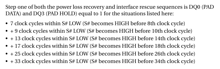

There is a section in the documentation called the Power Loss and Interface Rescue functions to reset the device to a fixed state (extended SPI) which is what I'm currently trying to do. However, I am having trouble understanding the documentation and have implemented it as shown below.
However, when testing this code, the device is still inaccessible only returning 0xFF consistently in read ID and other read functions.

Says to set DQ0 Bit HIGH on the pin interface, and DQ3/HOLD pin HIGH, and then clocking
Do you even connect the DQ3/HOLD pin in your design? Use a pull-up?
DUMMY_CLOCK is 0xFF in my code. Yes, DQ0 is connected to my MOSI line and DQ3 is held high by default using a GPIO pin.
Question, if I'm understanding this correctly, I should be sending 7 bits, cs HIGH, csLOW, 9 bits, cs HIGH, csLOW, then 13 bits, and so on?
My current implementation sends bytes currently so 7 bytes * 8 clocks / byte = 56 clock cycles.

You're sending a magic sequence of all ONEs to MOSI
You might have to do this sequencing void direct GPIO interaction, not using the SPI peripheral.
And you need a brief break time between sequences with the chip select.
Perhaps use a scope or logic analyzer to confirm the correct pattern if having trouble.
