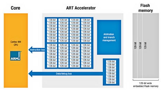

The reason to align a section is to permit things within that section to be placed up to that granularity. Multiple objects may feed into a single section.
All data and variables should be placeable at 32-bit boundaries. Data paths and memories are optimized and decoded on that premise. For flash the key thing to understand is the line width of the memory. Flash is slow (figure 35ns whether you read 1 byte or a dozen), if you read a value that spans two lines it will be doubly slow. The flash line width in the F4 is 128-bits, the cache (ART) sitting in front of it is also 128-bit wide. Subroutines and branch targets tend to work better if aligned, the initial hit occurs if there is a cache miss, but the next 7 instructions fetch for free as part of the optimized prefetch path.2014-01-10 8:59 AM

clive1: Where did you get that fancy graphic? I am confused by the block of 128-bit values. Thumb and Thumb-2 instructions either 16 or 32 bits so do they represent between 4 and 8 instructions? From the Architecture Manual ''While instruction fetches are always halfword-aligned, some load and store instructions support unaligned addresses.'' (so aligning to 16 bytes shouldn't be needed?) If I knew what the 128-bits represented I think I have a much better understanding. It looks like I need to read more about the ART as well.

@samuel - It's from one of the STM32F2/4 brochures. I'll dig one up shortly.
Remember this is external to the core, as the core designs don't provide any implementation for caching or TCM. The ART can provide prefetch data at basically zero-cycles, compared to say SRAM where it will still take a cycle to fetch. So from flash while you might have a 5 cycle hit for the first 16-bit word, the next 7 can be feed at 0 cost.2014-01-11 4:11 PM

It aligns the .text section to 4 bytes. Is any less valid than the way ChibiOS aligns the instructions?'' OK Atollic TrueStudio uses gcc as the compiler/linker. Yes, it aligns to 4 byte boundaries (due 32bit ARM architecture) ''Is any less valid than the way ChibiOS aligns the instructions?'' No, both ways are OK but in fact from what Clive1 said about the Flash and cache - it sounds like ChibiOS is trying to be clever and optimise Flash access for the STM architecture. What it is doing is forcing a 128 bit read (hence taking advantage of the Flash width and Cache) every time it reads an instruction, a number of instructions (4) are all read into the cache. Note : this does not guarantee ChibiOS runs faster then other Rtos' but is helps2014-01-13 5:26 PM
Thanks all, it is starting to come together. In the example below, which is an unoptimized function that adds two floats, I highlighted the first 128 bits of the function. Any idea how the ART handles only having half of the instruction stored in the cache? It is hard to tell from the presentation but perhaps it reads ahead and does not wait until a cache miss?
