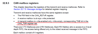

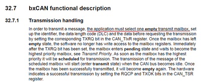

Second, not sure what the problem is, but when sending a CAN frame you need to select an empty mailbox (it's already managed in the HAL).
Please review the reference manual:
See also the HAL implementation of HAL_CAN_AddTxMessage():

2024-12-18 1:00 AM - edited 2024-12-18 1:26 AM
First, please see How to insert source code , I've edited your post.
