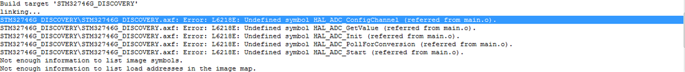

Check defines in stm32f7xx_hal_conf.h pulling in #includes, and that the stm32f7xx_hal_adc.c file is in the project tree.
This is a linker error not a compilation error, so indicates the code behind the functions is missing.

I have zero visibility into your problem, the linker says they are not there.
If the file is not missing, then you'll need to look to see if there is some ♯ ifdef around them preventing the body code from being compiled.
Enable 'Browse Information', and right click 'Go To Definition Of ...' at the places where you call the functions.

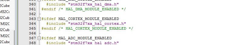

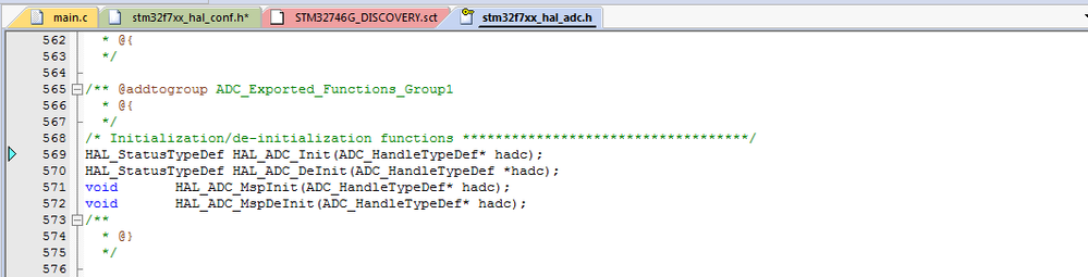

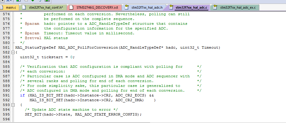

i hope this makes it clear for you, i've been trying for hours , it's the LwIP project from the STM32cubemx applications
2018-04-08 1:08 PM
Ok, so still points to HAL_ADC_MODULE_ENABLED not being defined. Select that text and 'Find-in-Files' within the project.
\STM32Cube_FW_F7_V1.11.0\Drivers\STM32F7xx_HAL_Driver\Src\stm32f7xx_hal_adc.c
&sharpifdef HAL_ADC_MODULE_ENABLED
&sharpendif
Should be in stm32f7xx_hal_conf.h
