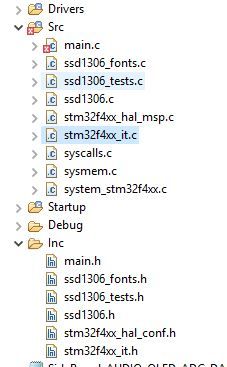

Make sure that the stm32xyx_hal_conf.h file for your project defines the TIM module for inclusion. And that the TIM library source files are in the project so the linker can get closure.

I checked it the "stm32xyx_hal_conf.h" is included in the main. but the same problem What's missing?

Is the error coming from the compiler or the linker?
Make sure you have stm32f4xx_hal_tim.c brought into the project.
Perhaps looks at some of the working project templates for your IDE
