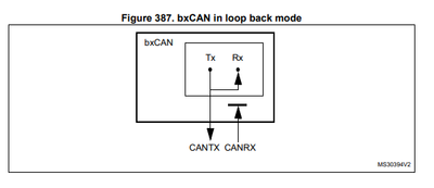

I have imported an example code of CAN protocol in loopback mode but unable to test the signal in DSO and as well as in CAN BUS ANALYZER can you please help me how to check the same in CAN BUS ANALYZER and as well as in the DSO from which pin i should check the signal and where i should connect to check the data in CAN BUS ANALYZER.

In loopback mode, you need to connect your analyzer or your oscilloscope only on the CAN_Tx pin.
2024-07-19 3:52 AM
