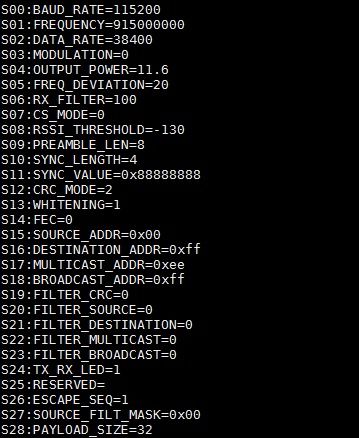

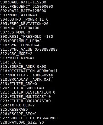

Default Settings:

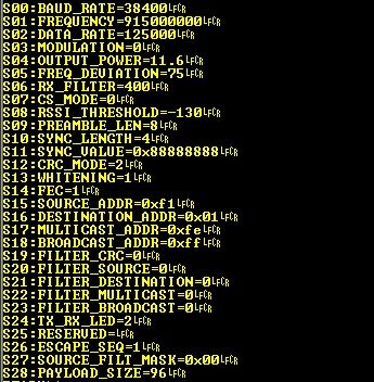

Final Settings:

Hello !
I don't have any experience with this RF module (I use custom made with cores from silabs)
I can observe that radio settings,isn't well adjusted.
For RF settings
Modulation 2FSK and freq deviation 20K and data rate 125000bps and Rx filter 100KHz are incombatible and can't establish an acceptable RFlink.
On 2FSK modulation BitRate must be <= 2*Deviation and Rx filter bandwidth must be at least 2*Deviation + BitRate (not including freq. offsets, freq. shiftings from temperature variations, etc.)
And in general, the higher the RX Bandwidth, the lower the sensitivity and the maximum link distance.
Other Modulations such GMSK have better spectrum usage characteristics and can icrease rate or distance of link (have different settings)

Thank you both for the replies. To be honest I have no idea about the communication part of electronics. I tried reading the theory part for more clarity but I couldn't relate all the terms from the theory to the ones here. And yes, it was indeed over optimistic to hope that all the data transmitted will be received so I'll take the suggestion to build a system with a ACK and NACK protocol.
I'm sorry to say but I still couldn't come up with proper settings for the modules to communicate with each other. According to the formulas I came up with numbers which I have programmed. I know it might be silly but I couldn't make it communicate at all. I think the numbers add up for the formula but I'm not sure what mistake I have made. I have a screenshot of one of the settings.
I would be obliged if you could point out the mistake.

2017-09-29 1:03 AM
I suspect you will not find it in the shown settings.
Rather I guess the firmware you are using is sub-optimal, i.e. can't keep up with higher data rates.
Single commands are 'short bursts', but larger files usually come as 'stream', and overwhelm simple buffer designs.
Either you design a more efficient reception handling, or use a handshake mechanism (hardware or software) to suspend transmissions while busy.
