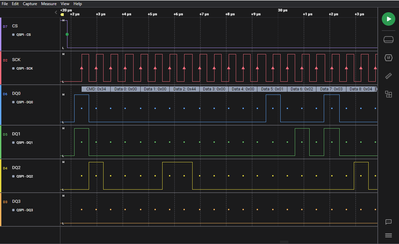

Here’s a screenshot of the command as well as the first four data bytes. The command is issued in quad mode:

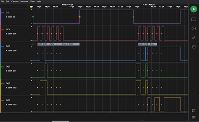

It takes about 4.2 milliseconds for the status register to go from 0x03 to 0x00 and for the flag status register to go from 0x01 to 0x91. Here’s a screenshot of that:
You’ll notice I read each of the registers twice, this is because the STM32 cannot go from writing to reading without 1 dummy cycle in between. So I read these registers twice and take the second reading as correct (in this case the two reads were identical, but this is not always the case). The datasheet indicates these registers can be read continuously. Though I only read them twice before re-issuing the command (so I can switch between reading the status and flag status registers).

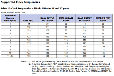

Could you please check the STM32H7 errata sheet and the max Quad SPI frequency mentioned in the STM32H7 datasheet and in the memory datasheet precisely for 4-BYTE QUAD INPUT FAST PROGRAM.

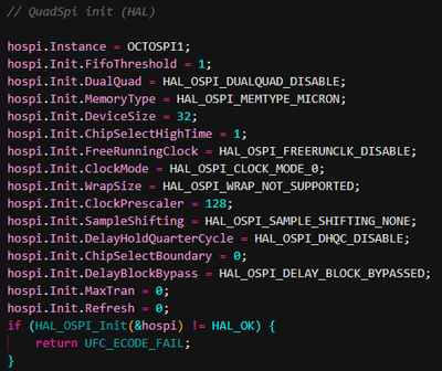

I am using an STM32H735ZGT6, indirect mode with OCTOSPI (using four data lines, since it seems like the STM32H735ZGT6 has OCTOSPI but not native QUADSPI). Here is the OCTOSPI HAL setup:

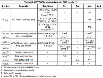

So the prescaler is 128 on a 450MHz clock, which means around 3.5MHz for the OCTOSPI clock, which should be definitely slow enough that it does not cause issues on the controller or peripheral side (here is the table from the Micron flash).
And here's the STM's OCTOSPI frequency table:
And I would imagine that if it's a clock frequency issue, the flash chip would not be able to respond with a 0x91 on the flag status, it probably would just not know what I even sent or have the ability to send back that status.

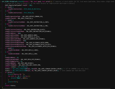

Here's the function I use to read the device ID from the MT25QL512ABB. This works in both single and quad mode:
And erase functions do succeed, as in, they do not return an error. But that could be because all of the data is already erased (all bits are set to 1) on the flash memory. Curiously, the write functions DO succeed (flag status returns 0x81) but only IF the data you are writing are all 0xFF bytes (so you can write all 1s to the flash which is already what it is, but if you even have a single 0 bit that you try to write then the flag status returns 0x91).

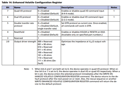

See my response to KDJEM.1 for additional information. TLDR: Erase functions work, I have read the Device ID but only the first four bytes, which are 0x20, 0xBA, 0x20, 0x10. I will read the extended device ID (5th byte) today when I get to the lab, but the only thing useful that could come out of that is whether the HOLD# or RESET# hardware is enabled but I've already disabled those functionality in firmware via the enhanced volatile configuration register (bit 4 is set to 0, since the value is 0x2F):

Could you please refer to AN5050 precisely section 6.2.4 OCTOSPI configuration and parameter settings table 8. and check the OCTOSPI configuration: Sample shifting, Delay hold quarter cycle and Chip select boundary...
