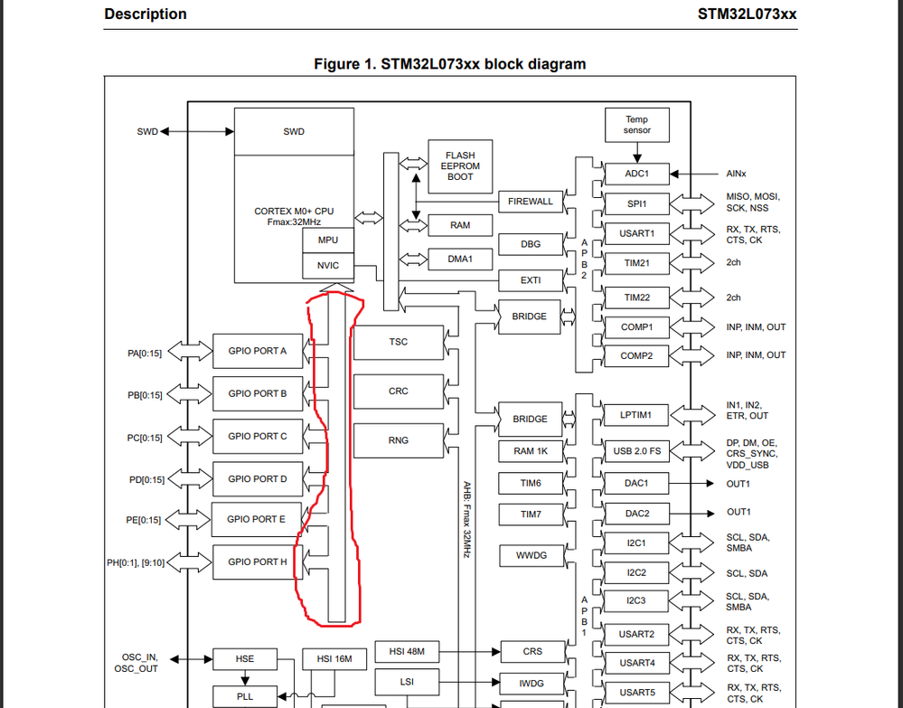

Can anyone help me find the Peripheral Bus to enable Clock for the GPIO Port on the STM32L073RZT6 microcontroller? Please find the screenshot attached.

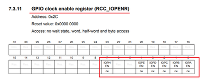

To enable the GPIO port clock you need to do that in RCC:
RM0377 rev / page 196:
