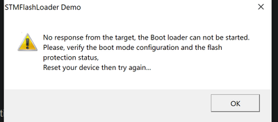

We are using the Flash Loader Demo exe for flashing
Getting below error while after applying above mentioned sequence of boot and reset pins
Please confirm if the above steps are correct and what must be done to enter the boot loader

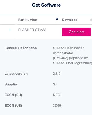

Dear @shraddhs10 ,
That utility is no more recommended for new design as below, please use STM32CubeProgrmmer instead and let us know if the behavior is the same ?

Connected how and with what?
CMOS level signals are not RS232 compatible
Noise on other inputs might be taken as first-contact, say a GPS/GNSS chirping continuously from startup.
Reset and try again
