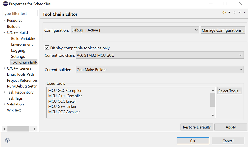

Consider defining your compilation tools, no idea of the context for this message.
2017-07-14 4:59 PM
Output.map's size is 432.068 bytes.
You can see my tool chain editor in the pic below:

2017-07-15 4:26 AM
