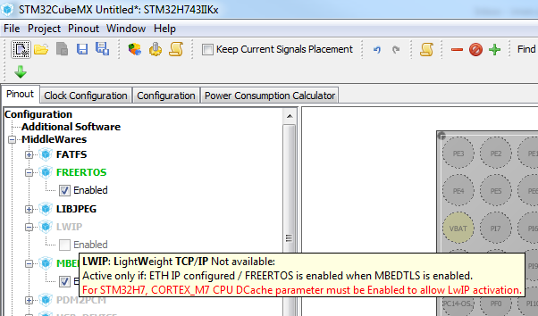

Hello
v.v.010
,As mentionned in the warning for LWIP, it will be active only if the ETH IP and FREERTOS with MBEDTLS are enabled.
Also for STM32H7, CORTEX_M7 CPU DCache parameter must be enabled.
Please try this configuration, then let me know if it is OK.
With Regards,
Imen

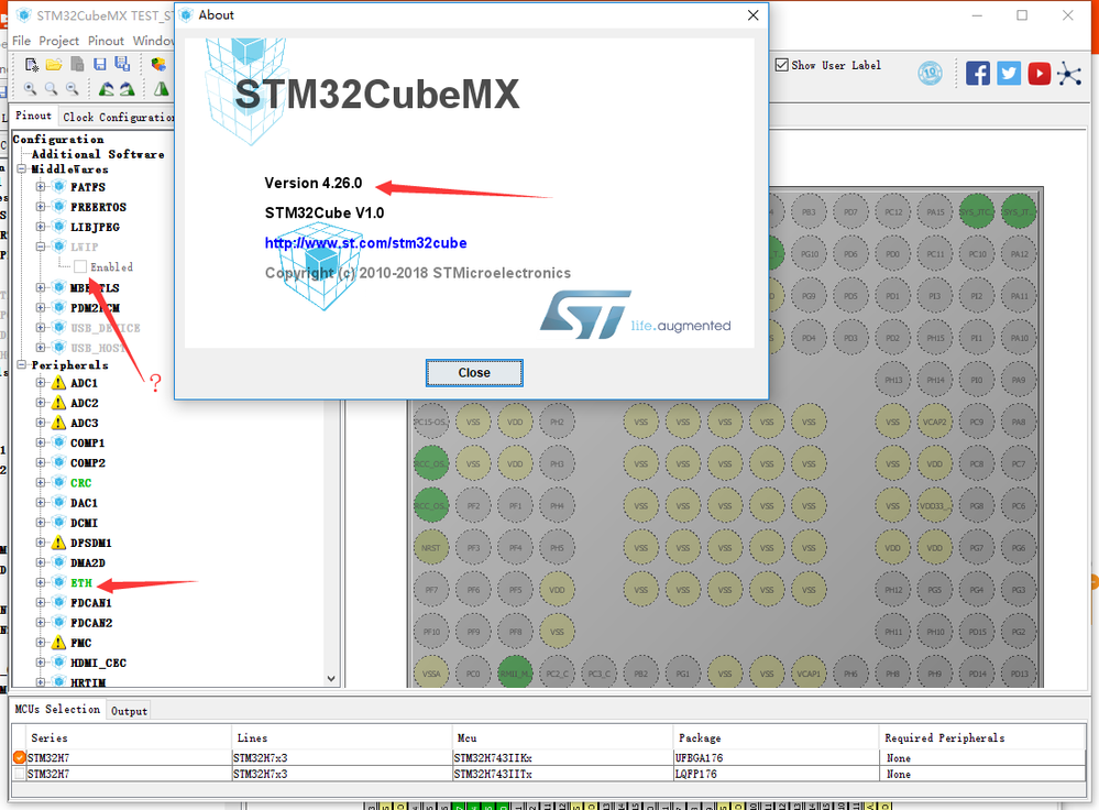

2018-06-28 8:17 AM
Thank you very much for your reply. You helped me very much.
