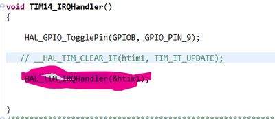

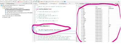

Hi @waclawek.jan
-> Timer started working now after enabling systick timer base
->I have enabled TIMx_ DIER . kindly check the below
-> Now issue is solved after clearing the interrupts
Thank you
