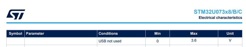

We are working on a project based on the STM32U073CCT6. The USB interfaces is not need. How should I connect the VDDUSB pin in order to minimize tthe power consuption? Is it Ok to connect it do GND?

read in ds...general/minimum working conditions.
2025-09-17 1:16 AM
Check this article FAQ: Configuring the VDD50USB and VDD33USB pins on... - STMicroelectronics Community
It should be helpful.
