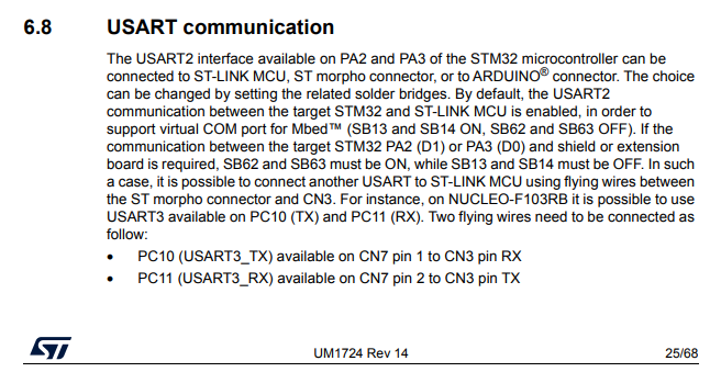

2024-10-16 2:10 AM - edited 2024-10-16 2:12 AM
Please see the Posting Tips for how to properly post source code:
Note that, by default, USART2 is connected to the ST-Link VCP:
