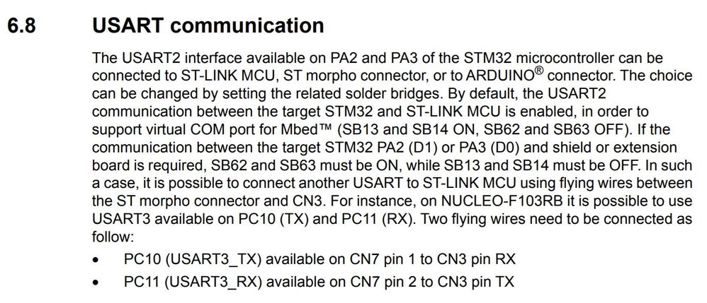

Check the schematic for solder-bridge options to route to VCP vs Arduino header vs pin headers.

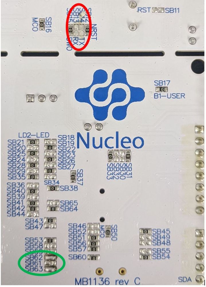

Hopefully this will help someone else. After following clive1's suggestion, I found this in the documentation regarding USART and solder bridges. That's what I did in the picture at bottom and everything works as I wished before. This was not in my radar, so better double check documentation next time. Thank you!
De-soldered 0 ohm resistor between SB13 and SB14 (red circle). Soldered bridges SB62 and SB63 (green).
