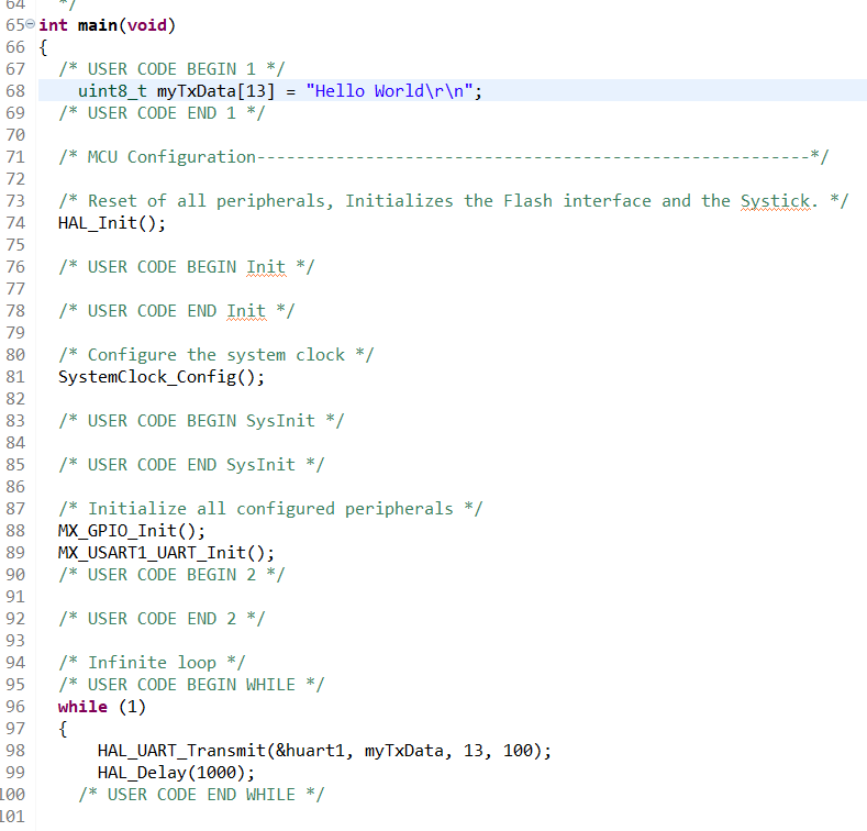

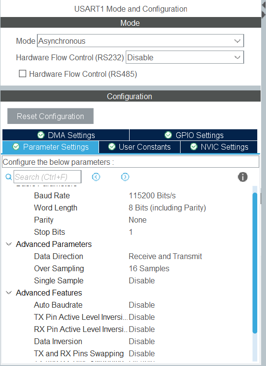

I would like to transmit data via USART and read the data sent to computer via a terminal(I have tried Putty and Real Term so far). To that end, I activate My USART configuration is seen as above. I also wrote the code below:
uint8_t myTxData[13] = "Hello World\r\n";
while (1)
/* USER CODE END WHILE */
/* USER CODE BEGIN 3 */
HAL_StatusTypeDef res = HAL_UART_Transmit(&huart1, myTxData, 13, 10);
if(!res) {
HAL_GPIO_TogglePin(GPIOI, GPIO_PIN_1);
HAL_Delay(1000);
}Note that I only put here inside the while loop. The other statements were generated by CubeMX.
Normally my code sends data to my pc if res is true, in other words, if it is HAL_OK, and also toggles the LED. Since it couldn't see the data in the terminal, I changed the condition in if statement, and saw that the led is toggled in each second. Therefore, I concluded that my USART channel does not work. What's the issue?
Thx for your help in advance.

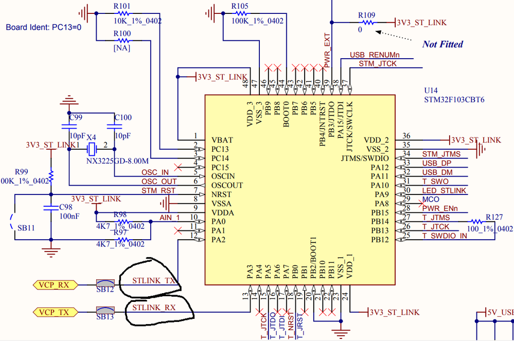

2022-06-01 5:27 AM
Your program runs on STM32F746, not on ST-Link CPU (STM32F103, which uses its PA2 and PA3 to connect to F746). The schematics of Discovery board shows the pins used in F746 for UART VCP connection are PA9 and PB7, which are USART1 TX and RX pins.

2022-05-31 12:26 AM
What is see is your timeout period is 10, change that to 100.
Next is check the baudrate on your serial terminal, it should be 115200.
It must work now!!

2022-05-31 9:37 PM
I am sorry for these missing parts. I am newbie to both embedded systems and the forums.
I am using STM32F746NG discovery board. I tried all USART channels but I still got nothing.The image above is a part of the schematic of my board. I activated PA2 and PA3 pins for UART TX and RX pins, respectively. I am not sure however if it is correct.
