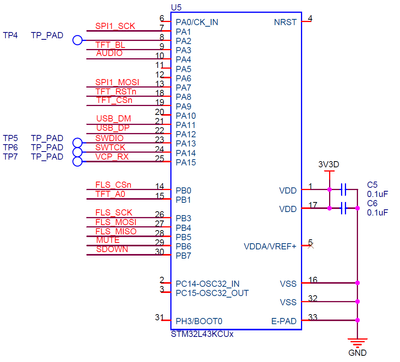

When I wrote the code created with CubeMX in the circuit in the attached image and executed it, it hung up at UART transmission.
This is a simple program with one line of additional code.(HAL_UART_Transmit)
What am I doing wrong?
I haven't been able to resolve it for a week.
2025-03-05 4:11 AM
To ensure proper user program start, BOOT0 must be at logic LOW - connected to GND directly or via resistor up to 100k.

Thank you everyone.
I solved it by connecting BOOT0 to GND.
I say hang-up because stepping does not return from HAL_UART_Transmit.
