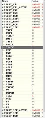

Read out and check/post UART registers.
2024-09-19 7:48 AM - edited 2024-09-19 7:50 AM
Hi @waclawek.jan , I added the CLK setup in the post attachments. There is a signal pretty frequently on the RX Pin. The UART Registers seem to be in order as far as I can tell (most of it is in the default reset value).
