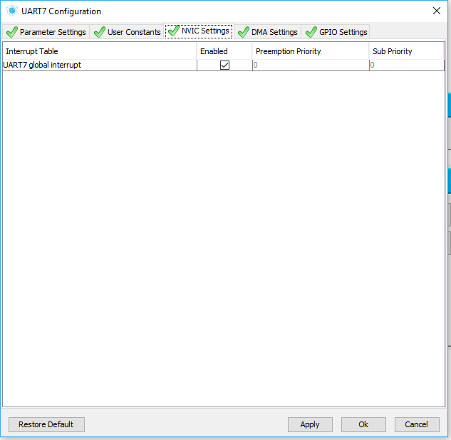

I have a problem with UART RX interrupt on a STM32F777.
I'm using cube mx, I've well enable interrupt in NVIC for my UART7.

Do you use the Cube ?
2018-07-10 12:23 AM
Yes, I'm using CubeMX.

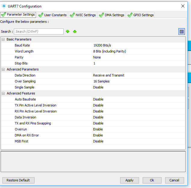

This is my UART configuration :
2018-07-10 6:13 AM
What is the return value from HAL_UART_Receive_IT()?
I execute the following sequence before the initial call to HAL_UART_Receive_IT():
__HAL_UART_CLEAR_OREFLAG(huart);
__HAL_UART_CLEAR_NEFLAG(huart); __HAL_UART_CLEAR_FEFLAG(huart); __HAL_UART_DISABLE_IT(huart, UART_IT_ERR);In the RxCpltCallback function only HAL_UART_Receive_IT() is called for the next character.
