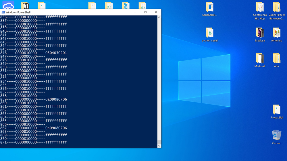

The STM32 receive the first pack of bytes, but than it returns always {0xFF, 0xFF, 0xFF, 0xFF, 0xFF} (ERROR). If you see the image, on the left there are the bytes sended by STM32, on the right the bytes sended through ST-LINK debug.
I can see the correct byte only when i reset the MCU, after the first read it return always error.

HAL_UART_Transmit and HAL_UART_Receive are both blocking. The device can only receive data when it's inside of the HAL_UART_Receive routine. If your other device sends data outside of this time, your program won't work correctly.
You can either work on the timing between the two to ensure data is sent only when the STM32 is inside the HAL_UART_Receive function, or you can implement nonblocking receive routines.
Putting a logic analyzer on the lines would show you exactly what's happening.
