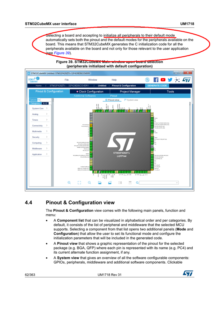

Googling yielded:
So, I'd recommend to check the GPIO registers for whatever pin are you using for Tx, too.
Or just don't use this option. I can't imagine what would it be good for.
