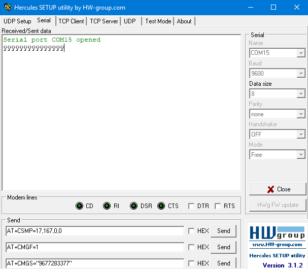

Hi, am using STM32F103C8T6, I wrote code with keil for uart1 for the tx pin PA9 and rx
pin PA10, am just sending a character repeatedly, but I didn't receive the character what I am sending, I am using CP2102 device between my controller and my PC. I will show my code, and my output , so kindly suggest me the solution.

{ // Update SystemCoreClock value SystemCoreClockUpdate(); // Configure the SysTick timer to overflow every 1 us SysTick_Config(SystemCoreClock / 1000000);OUTPUT:
}2018-05-28 5:40 AM
SysTick_Config(SystemCoreClock / 1000000);Honestly ?
Think about the implications.
Especially in the light of this:
USART1->BRR = 8000000L/9600L;
Are you sure ?
2018-05-28 5:52 AM
Is APB2 running at 8 MHz? Check what is happening in SystemInit()
Output a 'U' character continuously, and scope the USART1_TX pin and confirm the bit timing.
Use a debugger and inspect the RCC, GPIO and USART register settings
