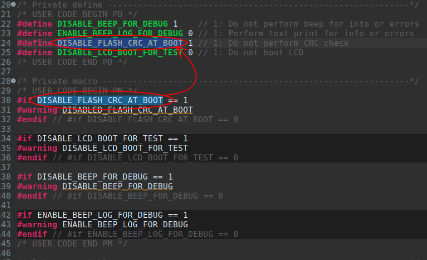

In this case, if you have the complete project, from where these files were obtained: there is a function in STM32CubeIDE that "Opens the declaration" (keyboard shortcut: CTRL+Mouse click on the word). Or you can also click once on the word to select it and press the F3 key.
But if you don't have the complete project, you can put the declarations in any file that this file has access to, maybe in the file itself, or in main.h for example.
#define USE_LOGGER 1
#define LOGGER_ON 1

2023-08-07 1:59 AM
#define LOGGER_ON 1
2023-08-10 3:31 AM
Thanks, your tip help me to find out that USE_LOGGER wasn't never defined :thumbs_up:
