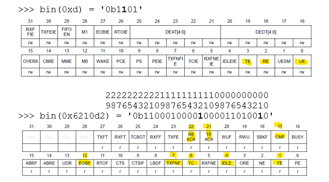

First, I have no clue why this IRQ is fired at all. In my understanding, in order to fire an UART IRQ, the appropriate enable bits must be configured in CR1-3. In this case, only in CR1 the RE, TE and UE are set.
Here is the content of CR1 and IRQ registers when the UART IRQ handler is fired:

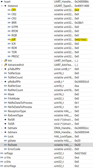

CR3 is 0, FE IRQ is not enabled. Here is what the debugger watch window looks like when the IRQ handler is entered and the local variables (isrflags, errorflags, ...) are read:
2025-06-04 11:57 PM
As there's no interrupt source enabled in CR1 nor CR3, I have no explanation why IRQ Handler is called. I guess you already checked thet UART IRQ Handler call is properly associated to the right IRQn ...
