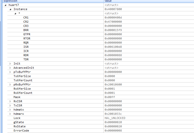

}The above code is what I use trying to switch between Character match (CC) and normal interrupt, so if the program detect 'G' it will switch to interrupt each character received. however after the switch the UART seems to not generate any interrupt anymore and overflow flag is set and here is the register:
I thought we just need to set USART_CR1_CMIE and ADD ? am I missing something ?
