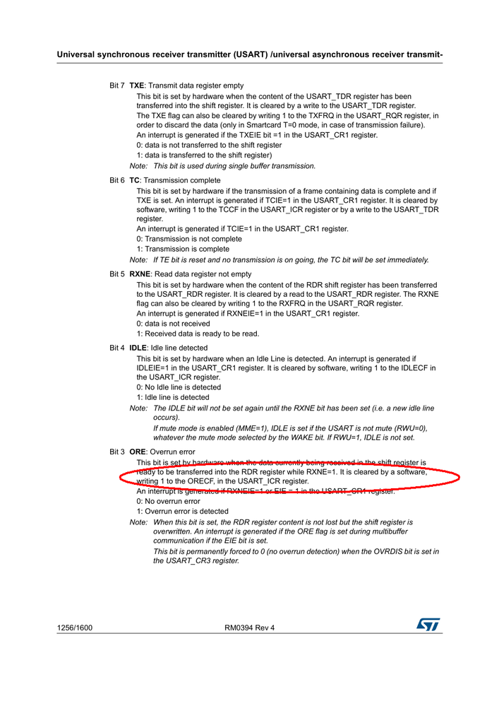

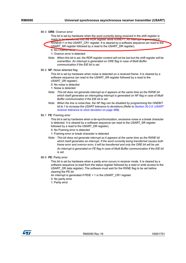

Depends on the model of STM32, the Reference Manual should describe how to clear, and which register to use.

> How to clear ORE bit it goes high
This is why it's important to tell, which STM32. There are 2 different UART modules in the various STM32 and the procedure is different too - but in any case, it's in the RM, so it's enough to read it and follow it.
So, check in the RM for *your* STM32.
